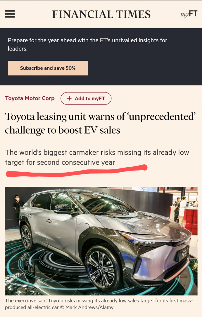

Toyota is coming under increasing pressure from investors to hone its EV strategy, with the botched launch of the bZ4X fuelling concern that the carmaker is falling behind rivals. Toyota resumed production of the bZ4X in October, after addressing issues with bolts that could cause its wheels to fall off.
“This was the first time in Toyota’s history that a recall occurred immediately after the product was launched, causing production and sales to be suspended for several months,” said Shinya Kotera, president of Kinto, a Toyota leasing subsidiary that exclusively delivers the model in Japan.
“Toyota is in an unprecedentedly difficult situation, and the recall threw [the bZ4X launch] off track,” Kotera said, in an interview at a Kinto office in Tokyo.
