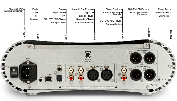

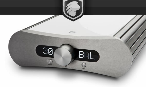

Gato Audio PRD-3 preamplifier with DAC
"The DIA amplifier family will from February, include a fair priced preamplifier⁄DAC called PRD-3. Based on the DIA integrated amplifiers it offers a very good sounding, straightforward preamplifier that includes the DAC circuitry from DIA-250 and DIA-400. It has exactly the same features as the DIA's but without the output stage and of course it is offered at a very nice price point. The retail price will be around 2.495 EUR."
More than just a Preamp
The built-in D/A converter offers real high end performance, enabled by the use of a dedicated power supply, a balanced-drive Burr-Brown PCM1794 D/A converter, an optimized high bandwidth I/V converter, and an analogue stage with low-Q, low pass filters. All digital inputs are upsampled to 24bit/192kHz. This D/A converter will upgrade any digital source - such as wired or wireless streaming from your computer or CD drive - to a high end level of detail and musical performance.
Versatility and Connectivity
We had our eye on versatility and connectivity when designing this preamplifier. The PRD-3 offers not only a wide range of digital and analogue inputs, but also line outputs, a trigger signal for external power amplifiers, and a configurable home theater input. The HT input can turn the preamplifier into a fixed level preamplifier for use in a surround setup, without compromising the sonic performance.
Features:
Built in 24bit/192kHz D/A converter with upsampling
Coax, optical and asynchronous USB digital input up to 24bit/192kHz
Accepts digital streaming directly from Apple iPad
Two unbalanced and one balanced inputs
One unbalanced and two balanced outputs
Nonmagnetic enclosure
Direct function; enables use in home theatre systems

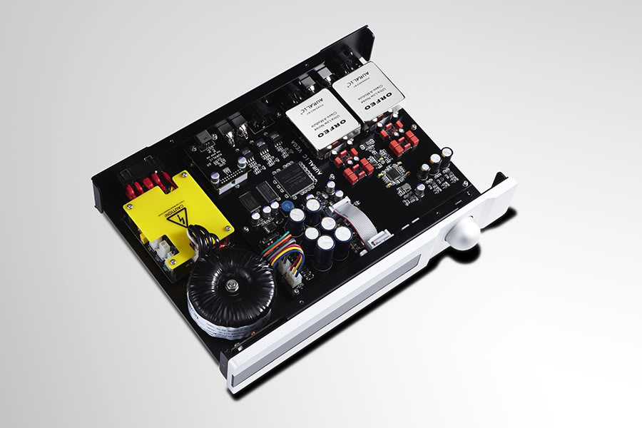

AURALiC VEGA
για διαβαστε παρακαλω......κατι εχει να μας πει.........
With Sanctuary Audio Processor as heart, AURALiC introduces several cutting-edge technology for VEGA: 'Megahertz upsampling' algorithm processes all PCM music to 1.5MHz in 32bit; 'Femto Master Clock' provides an ultimate clock precision with jitter only 82 femtoseconds(0.082 picoseconds). Binding with other AURALiC's patented technologies such as 'ORFEO Class-A module' and discrete 'Purer-Power™ solution', VEGA will bring high resolution music playback experience to climax.
VEGA supports all high resolution music formats including DXD(352.8KS/s, 384KS/s in 32bit) as well as DSD stream at 2.8224MHz and 5.6448MHz. Five digital inputs include AES/EBU, Coaxial(set of two), Toslink and USB. The balanced and single-ended analog outputs can connect to power amplifier directly, adjusting volume in digital precision without dynamic loss. VEGA has six built-in filter modes allows its user to customize according to different music formats, tuning sound best to personal preference.
"VEGA is an unique design, It not just supports all high resolution music format, but also powerful in its advanced function. It is the approach to real high-end that most enthusiastic audiophile long for", said Xuanqian Wang, "like other creation from AURALiC, the ingenious design of VEGA bringing you enjoyment in both aural and visual".
Suggested retail price: VEGA: $3,499/ €3,299(incl. VAT)
Πρώτα διάβασα αυτό:
"Auralic's Vega D/A processor offers measured performance that is beyond reproach"
http://www.stereophile.com/content/auralic-vega-da-processor-measurements
και αμέσως μετά αυτό:
"Λαμβάνοντας το συνολικό πακέτο των μετρήσεων υπόψιν, ο μετατροπέας της Auralic φαίνεται να είναι αυτός με την καλύτερη συμπεριφορά που έχουμε μετρήσει μέχρι σήμερα και μάλιστα με διαφορά."
που πρώτος είχε γράψει ο ένας και μοναδικός δικός μας DStam:
http://avmentor.gr/reviews/auralic_vega_2.htm
και με minimum phase φίλτρο, και καλό προενισχυτικό στάδιο, και λογική τιμή, τι άλλο θέλει κανείς; (ΟΚ, εγώ θέλω περισσότερα κανάλια, αλλά τέλος πάντων...)

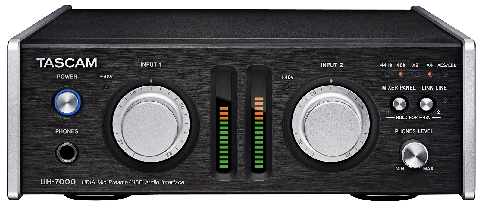

Tascam UH-7000
The UH-7000 is a pro-level microphone preamp and audio interface designed with a strong focus on low noise and high audio quality. Not only can this unit be used as a 4-in/4-out audio interface in a DAW production environment, but as a standalone microphone preamp and A/D / D/A converter. The built-in HDIA (High Definition Instrumentation Architecture) microphone preamps are newly designed and perform at ?128 dBu equivalent input noise, a signal-to-noise ratio of 117 dB and distortion of 0.0009 % or less.
The grand nature of the UH-7000’s sound is partially due to the careful attention spent on selecting parts. In addition to Burr-Brown converters and metal thin-film resistors, installed is a powerful TCXO clock generator with a precision of ±1 ppm.
The unit’s half-rack size makes it easy to install at a studio console or work desk. The thick aluminum panels used on the front and sides of the full-metal body help increase stability. Highly important but easily forgotten about are the smooth-tension aluminum input level knobs for precise level adjustments.
The UH-7000 microphone preamp and audio interface enables composers, musicians and recording engineers to produce music in their private quarters at a level generally reached only in professional studios.
Main Features
  • Top-of-the-line two-channel USB audio interface for Windows and Macintosh computers
  • Can be used as a stand-alone high-end AD converter for monitoring or recording to stand-alone recorders
  • High-performance mic preamp newly designed for this model reduces influence of impedance mismatch with high accuracy resulting in most accurate audio reproduction at the input stage
  • Superb audio quality with samling rates up to 192 kHz at 24-bit resolution
  • Ultra-high dynamic range of 123 dB (A/D) and 128 dB (D/A)
  • Professional-grade PCM4220 A/D and D/A converters from Texas Instruments
  • Selected components like metal film resistors and film capacitors for outstanding sound quality with noise and distortion minimized to a minimum
  • High-precision clock synchronization with sample-accuracy at both recording and playback
  • On-board DSP mixer and effects like EQ, compressor, noise suppressor, de-esser, exciter and reverb (effects up to 96 kHz only)
  • Two selectable mixer modes:
  • Multi Track mode for DAW recording and composing: Create a monitor mix independent of the actual recording levels
  • Stereo Mix mode for internet broadcasting and video editing: Create a stereo mix of two different sources plus loop-back signal from the computer
  • Mixer panel for intuitive mixing and effects handling on the computer screen
  • Dedicated button for opening/closing the mixer panel on the computer
  • Two large TRIM knobs for precise level adjustment
  • XLR and TRS balanced analogue inputs
  • Switchable 48-V phantom power on XLR inputs
  • XLR balanced line outputs
  • Line output level can optionally be adjusted with the headphones level control
  • Output selector allows a source to be output via the unit's mixer or via a computer connected by USB
  • Powerful headphones output with dedicated level control
  • AES/EBU digital I/O
  • Low-latency monitoring
  • Easy-to-read 20-dot LED level meter
  • Aluminum front and side panels for long durability even under tour conditions
  • Half-rack size
$600
http://www.tascam.eu/en/uh-7000.html
1.985
766
το Tascam UH-7000 απο πανω και συσκευες παρομοιες, κατα ποσο μπορουν να συγκριθουν με dac/pro τυπου Grace, Benchmark, Mytec κλπ?
δλδ εννοω οι δυνατοτητες του tascam, θα αξιοποιηθουν απο ενα χρηστη που απλα ζηταει ενα pro/dac να παιζει hd υλικο?
δεν ειναι ας το πουμε, γι αυτους που εχουν καποιες γνωσεις πανω-κατω και θα αξιοποιησουν ενα τετοιο εργαλειο?
το λεω γιατι η διαφορα στη τιμη, σε σχεση με τα αλλα γνωστα dac (grace κλπ), ειναι σημαντικη...
ακομα και αν λοιπον, δεν χρησιμοποιησεις τα "καλουδια" του tascam, αξιζει κανεις να το "χτυπησει" μονο ως dac/pro?

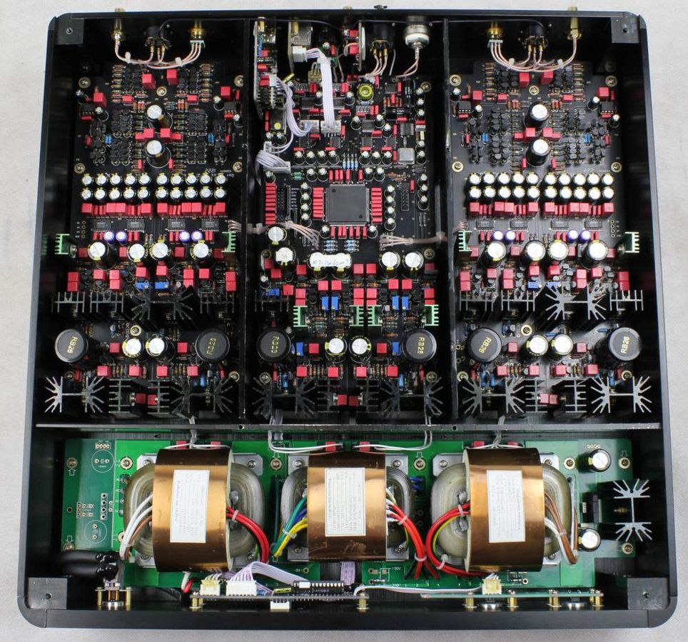

Αν μιλάς από άποψη υλικών,πολλά την δικαιολογούν..
Κοίταξε πχ. το παρακάτω της audio-gd που το έχω άχτι.
Βάλε σούμα τα υλικά σε diy κατάσταση (χωρίς την εργασία) και θα δεις πως βγαίνει παραπάνω.(Τσεκαρισμένο αυτό.)
