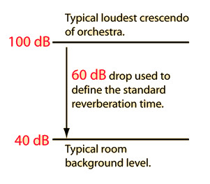

Για αυτό τι λέτε? Έχουν σχέση τα 100 db με την μέτρηση? :rolleyes:
Rationale for 60dB Reverberation Time
The reverberation time is perceived as the time for the sound to die away after the sound source ceases, but that of course depends upon the intensity of the sound. To have a reproducible parameter to characterize an auditorium which is independent of the intensity of the test sound, it is necessary to define a standard reverberation time in terms of the drop in intensity from the original level, i.e., to define it in terms of relative intensity.
The choice of the relative intensity to use is of course arbitrary, but there is a good rationale for using 60 dB since the loudest crescendo for most orchestral music is about 100 dB and a typical room background level for a good music-making area is about 40 dB. Thus the standard reverberation time is seen to be about the time for the loudest crescendo of the orchestra to die away to the level of the room background. The 60 dB range is about the range of dynamic levels for orchestral music.
http://hyperphysics.phy-astr.gsu.edu/hbase/acoustic/revtim.html#c2
skaloumbakas
4Haris
24.751
1.677
As defined by Sabine, the RT(60) is the time taken for a continuous sound within a room to decay by 60 dB (one million times) after being abruptly switched off.
Το 100dB είναι μια βολική ενταση για να πεσει το επίπεδο του ηχου στο επίπεδο του συνηθους θορύβου σε ενα δωμάτιο (40dB)...
